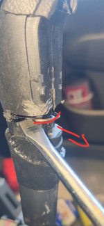

2- Cut the leather in the rear of the handle to expose the access point
3- Pull out the cover that covers the retaining ring
4- Use a pick to pry out the retaining ring

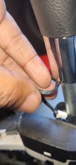

5- Under the shifter, disconnect the wire from the plug
6- Pull straight up to remove the shifter

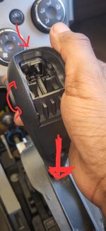

8- Remove the plastic case surrounding the button by prying from the right and left side of the shifter.
9- Remove the top/rear cover of the shifter by prying up and back on the plastic center piece.
10- Use a small tool to remove the pin holding the button in place (located below the button in front.
11- Pull down and forward to remove the button

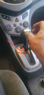

14- Slide the shifter down and reconnect the connector
16- Push down firmly on the shifter to seat it. Test the shift button, if there's no rebound it means the shifter isn't down all the way. Once the button works, start the car and Test the manual shift buttons.
