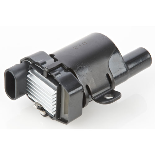

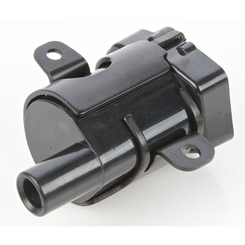

Besides having owned a lot of various LS powered things, I also own a Mazda Miata. It runs a standalone (MegaSquirt), and on that car I chose to use the GM D585 (AC Delco PN: 19005218) coils. These are all over the junkyards CHEAP, and a pretty hot coil. I typically snag them off early/mid 2000's truck and SUV's. I'm not saying these are THE BEST GM COILS, but it's light years ahead of most stuff and what comes on the Sonic. You are typically talking 40kV+ on the better models of LS coils.
One thing to know about the D585 is that its a semi-intelligent coil. It is known to fire when saturated > ~4.5-5 milliseconds dwell no matter what you tell it. This is more of an issue for the people making extreme (think 1000+) horsepower, and why it has fallen out of favor a bit.
You will need four of these. If you buy them at the yard, snip off the connector leads too.
I highly recommend genuine/OEM coils. The Chinese junk (even AC Delco branded) have often proved to be unreliable or not perform. That goes for any LS coil really in my experience. This is what the D585 looks like:

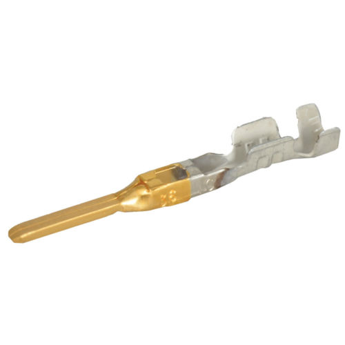

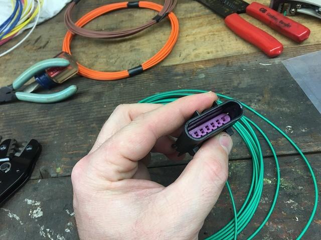

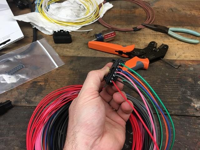

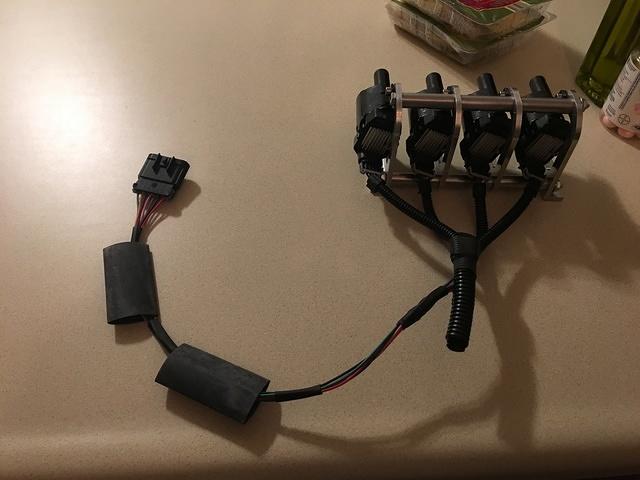

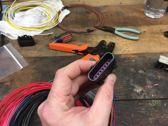

Male ignition plug connector, pins, wire and wire seals:
I want my conversion harness to look OEM and professional, so I put in the work to track down the part number of the coil side plug, pins needed and wire seals. The harness plug is what mates with the stock engine harness coil pack plug, if that wasn't clear.
Harness Plug - Qty. 1 PN: 15359189
Pins - Qty. 7 (I recommend buying more!) PN: 54001845

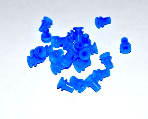

Wire Seals - Qty. 7 PN: 15366021 OR 15366060, depending on what gauge of wire you use. More on that below.
15359189
54001845
15366021
15366060

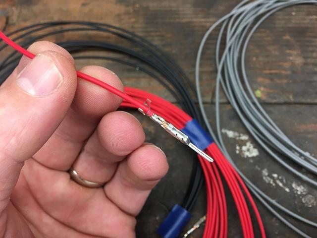

I am using an assortment of 20AWG TXL wire to complete the project. I looked at the car side of the harness, and it seemed to be about what they are using. If I need to upgrade sizes later (would only be on the +12V and negative if I did) I can. I just have piles of this stuff around from building harnesses for other stuff. Since I am using 20AWG, the white seals (15366021) work fine. If I was going larger, I would need to use the blue (15366060) seals.

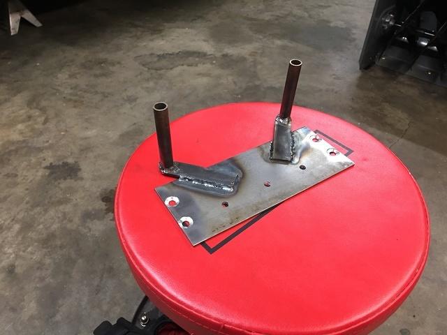

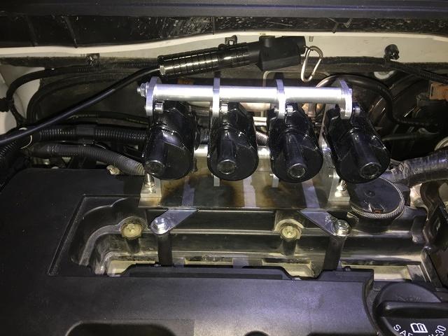

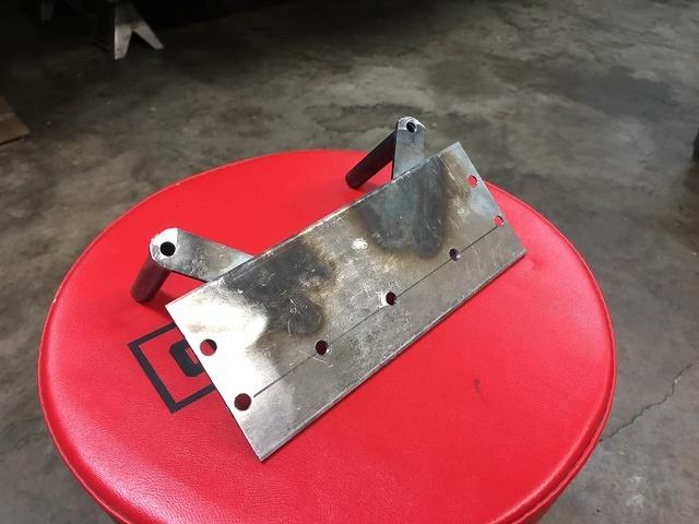

Coil Bracket:

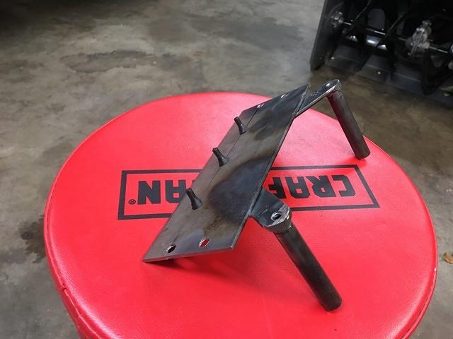

I will be using ICT Billet PN: 551562 D585 coil relocation bracket. I am unsure yet if I will mount the coils to the valve cover, the firewall, or some other place. It actually comes with two brackets, so you can make another set for a friend or .. whatever.
https://www.amazon.com/dp/B01M4LYET8
It should go without saying you can make your own bracket, or re-purpose a bracket off an LS motor (they bolt to the valve cover) if you are very budget minded. I almost did the latter, since I have a ton of them in a box... but wanted something a little nicer looking

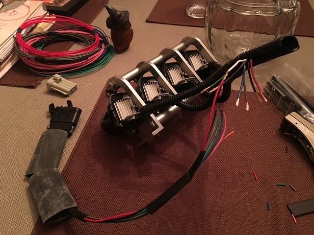

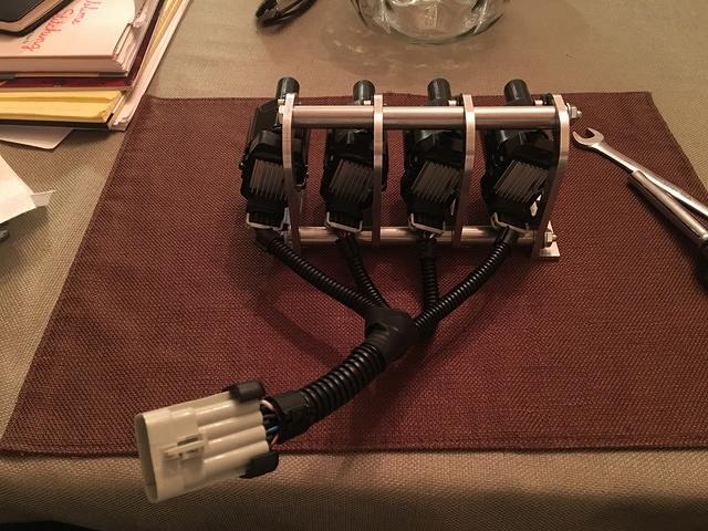

Here is what my ICT Billet brackets look like with the coils assembled on the bench:

Wiring Diagrams
Ignition connector pinout (NOTE: this is as viewed from the engine harness!):
Ignition coil pinout:
Full wiring diagram to coils:

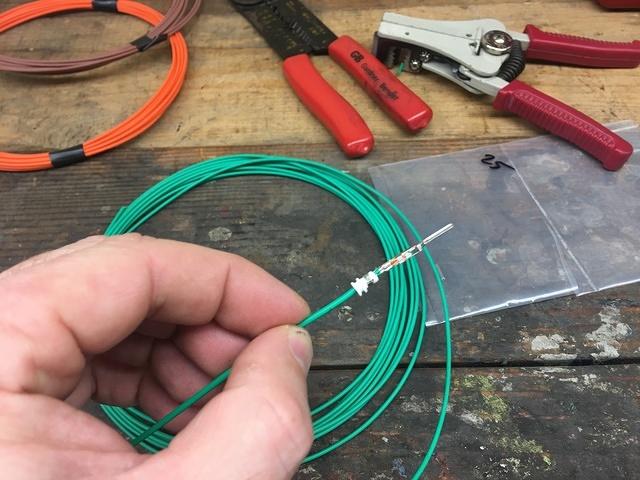

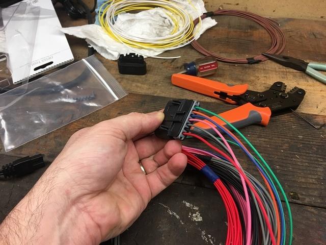

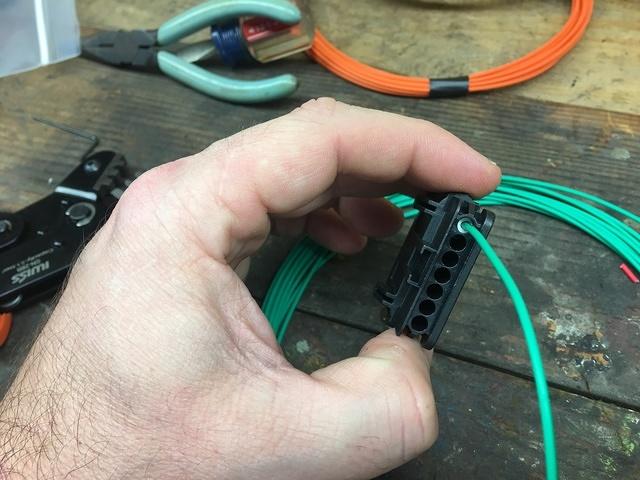

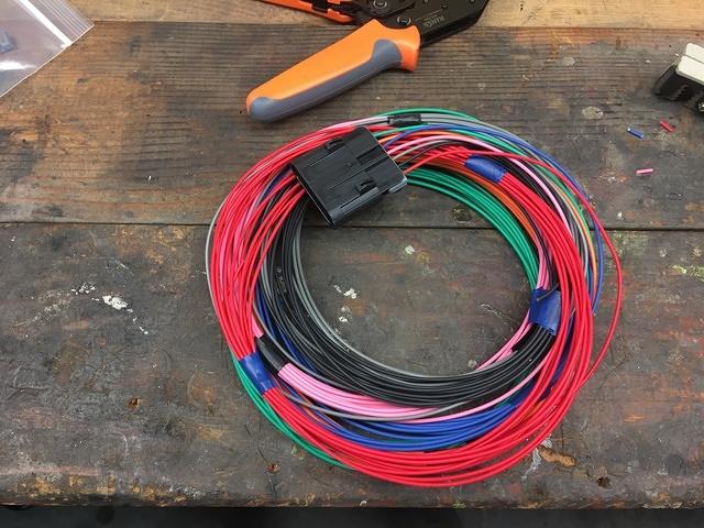

15359189
54001845
15366021
15366060

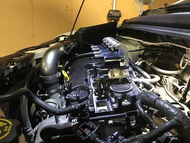

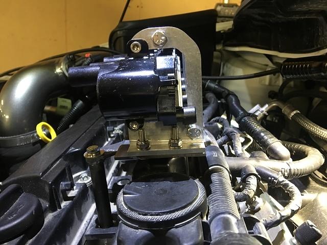

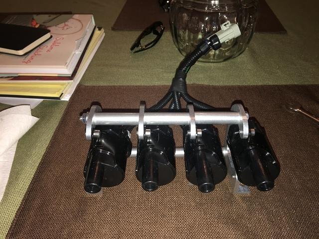

Coil Bracket:
