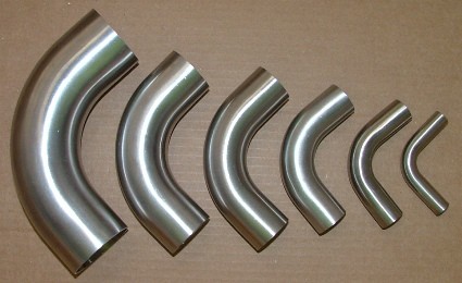

A mandrel bend keeps the pipes original diameter through out the bend. Most exhaust shops "crush" bend causing dents and wrinkles in the pipe reducing the pipe diameter and increasing the flow restriction.

I was asking if the 3" pipe the Op had installed was all mandrel bent or not?I hate crush bends and would never put them on another vehicle. Years ago I had a chevy C2500 with a 350 and had a flowmaster 40 + 3" system on it which was mostly crush bends, later I swapped in a flowmaster catback system and couldn't believe the difference the mandrel bends made.
