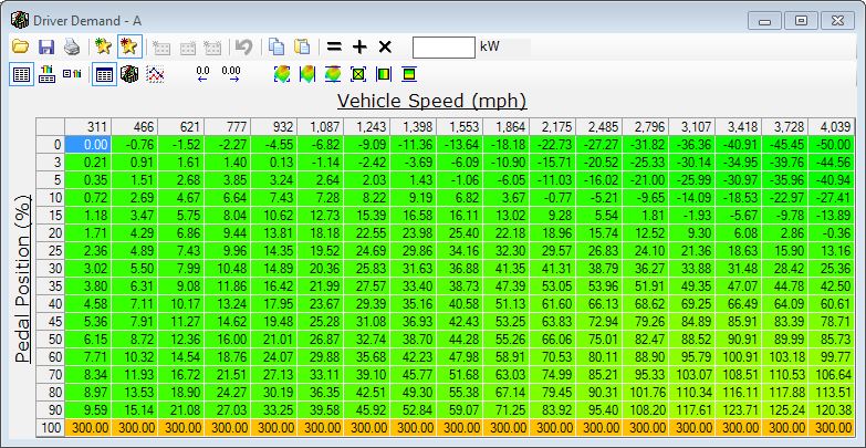

Fourth table is Driver Demand A:
As is probably obvious, below 100% pedal position it drives very stock.

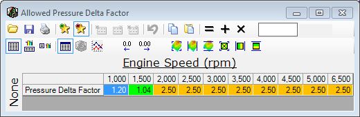

Seventh table is Allowed Pressure Delta Factor:
