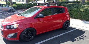

Looks good! Keep going around the tire tho. More HP
What rims ?
Stock rims from the premier trim. Just put 215 on tires instead of stock 205.

Now ya-gots me thinking about painting mine -- matt black ?I painted my wheels over the last 2 days.
Rims had a lot of curb rash, factory paint was peelings, etc.
Used Liqui Moly Wheel and Mag cleaner. Best auto cleaning product I've ever used.
Sanded rough spots down using 120 paper, added body filler in all the deep scratches and sanded that down some more. Then went over everything with a 400 grit paper to get rid of the 120 grit scratches.
Laid down 3 coats of white primer and let that dry over night. Sanded the primer down to a smooth finish with 600 grit paper then put 3 coats down of gun metal base coat with 10min spaces between each coat.
Let the final coat cure for 30min and then did 3 coats of gloss clear with 20 minute spaces between each coat.
Sanded the centre cap edges down with 400 grit paper, masked up the emblem and then 2 coats primer, 2 base and 2 clear.
I'm quite happy with the result
